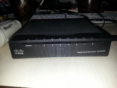

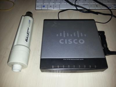

Продам 8порт Cisco SLM2008 8x Gigabit 90 USD Ubiquity Bullet 2HP в подарок (рабочий но без блока питания) ! Features • Eight 10/100/1000 Gigabit Ethernet ports • 16 Gbps, nonblocking, store-and-forward switching capacity • Supports IEEE 802.3af PoE-PD on port 1 as an optional power supply • Simplified QoS management using 802.1p and DSCP traffic prioritization specifications • WebSmart management enables configuration and monitoring from a standard web browser • 802.1Q-based VLANs enable segmentation of networks for improved performance and security • Port-level security via 802.1X authentication • Increased bandwidth and added link redundancy with Link Aggregation Control Protocol (LACP) • Storm control on multicast and broadcast traffic • Many-to-one port mirroring for noninvasive monitoring of switch traffic • Jumbo frame support (9 KB) • Support for simple interface counters http://www.cisco.com/c/en/us/products/collateral/switches/slm2008-8-port-gigabit-smart-switch-pd-ac-power/data_sheet_c78-500596.html
