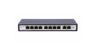

Poe Switch 8 x 100Mbps Ethernet ports, 2 x 100Mbps up-link port 83$ post-31370-0-63720400-1513070768_thumb.png

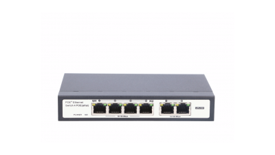

Poe Switch 4 x 100Mbps Ethernet ports, 2 x 100Mbps up-link ports 41$ post-31370-0-02901900-1513070751_thumb.png
