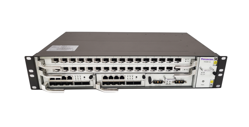

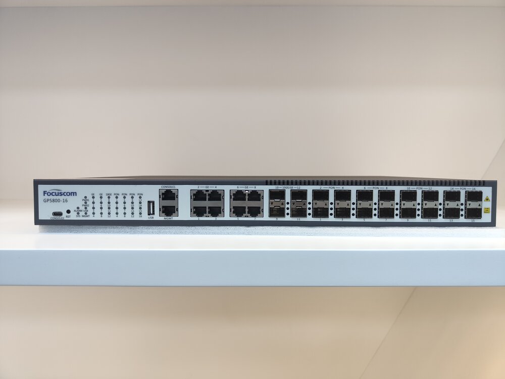

      L3 GPON 2 port OLT, in stock now! Send inquiry if you need it.
      WEB managed, 256 users the max
