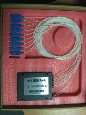

Продам CWDM Module Multiplexor
CWDM Module 1*16 (1310NM-1610NM)-315 $
CWDM Module 1*18 (1270NM-1610NM)- 346$
CWDM Module 1*2 (1530NM-1550NM)- 40 $
CWDM Module 1*4 (1510NM-1570NM)- 80 $
CWDM Module 1*4 (1511NM-1571NM)- 160 $
CWDM Module 1*8 (1470NM-1610NM)- 155 $
CWDM Module 1*8 (1471NM-1611NM)- 315 $
