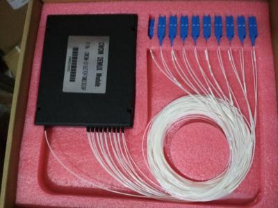

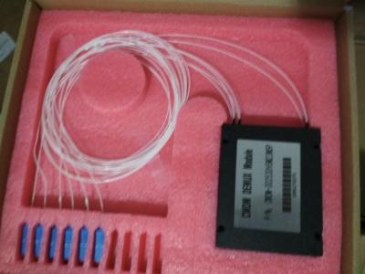

Продам CWDM Module 1/2, 1/4, 1/8, 1/16, 1/18
CWDM Module 1*16 (1310NM-1610NM) - 313 usd
CWDM Module 1*18 (1270NM-1610NM) - 346 usd
CWDM Module 1*2 (1530NM-1550NM) - 40 usd
CWDM Module 1*4 (1510NM-1570NM) - 80 usd
CWDM Module 1*4 (1511NM-1571NM) - 160 usd
CWDM Module 1*8 (1470NM-1610NM) - 155 usd
CWDM Module 1*8 (1471NM-1611NM) - 315 usd
