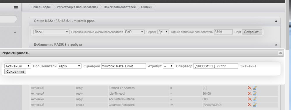

Hello What are the possibilities of using this configuration in КучаГен?
What should I place here?
Share this post
Currently mikrotik burst limits have no multigen macro. If someone tell me how final attribute should look like - i can do it in 20 minutes, for future releases.
Share this post

Here an example
                     64k/64k                            256k/256k 128k/128k                                                       10/10
                {SPEEDMRL}                            {SPEEDMRLB} {SPEEDMRLBTH}
                             {SPEEDMRLBT}
                        rate                               burst-rate   burst-threshold                                  burst-time
Download speed / Upload speed
Burst Download speed / Burst Upload speed
Burst Download Time speed / Burst Upload Time speed
 64k/64k              256k/256k      128k/128k    10/10 -          rx/tx-rate=64000, rx/tx-burst-rate=256000, rx/tx-burst-threshold=128000, rx/tx-burst-time=10s
as what I write is not well understood
 because I speak Spanish and the translators do not translate well
I place these images
 I hope the idea is understandable to you.
