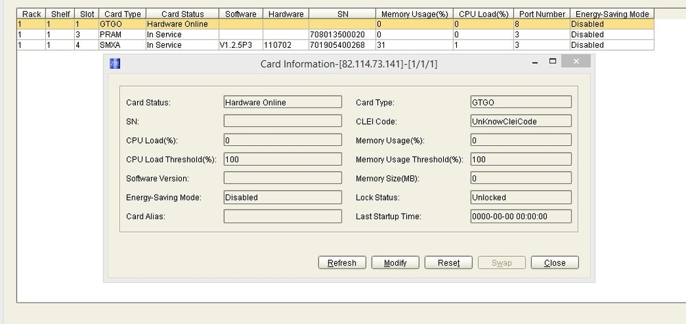

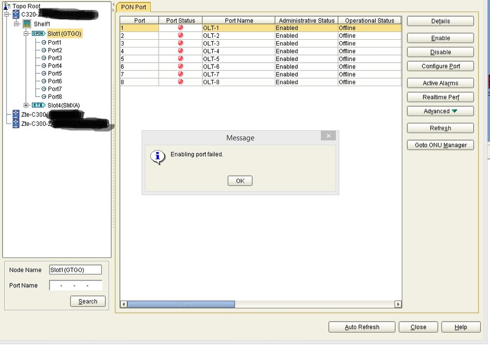

GoranSrb Опубликовано: 17 мая, 2021 Опубликовано: 17 мая, 2021 Can somebody help about this what going on. OLT C320, board GTGO HWONLINE. Space.Net-C320(config)#sho card Rack Shelf Slot CfgType RealType Port HardVer SoftVer Status ------------------------------------------------------------------------------- 1 1 1 GTGO 8 HWONLINE 1 1 3 PRAM PRAM 3 V1.01 INSERVICE 1 1 4 SMXA SMXA 3 110702 V1.2.5P3 INSERVICE
