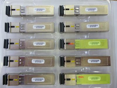

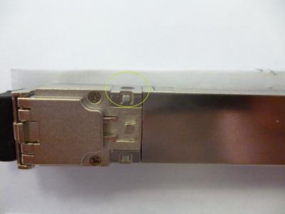

There are some troubles with SFP WDM 3/20km SC.
First of all, many non-working modules: 2 out of 40.
There are 2 modules RMA!!! RMA(Return Merchandise Agreement) – bad ones
In this modules RX not work. I think that the number of non-working modules on a large quantity may be more, as we have received samples, which (in my opinion) is given more attention (to show the best performance in quality).

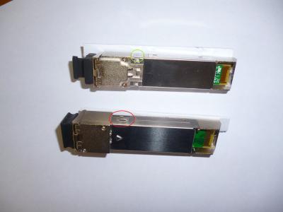

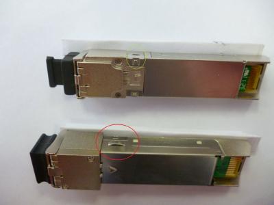

Second: there is problem with switches which has ports that are located closer to each other (such as D-Link DGS-3120-24SC). Photo below:
We think that problem in the construction of the body of the transceiver: spacers must be less in height. Photos are below:
Also patch cords with SC connectors are bad held in the SC socket of transceiver. If you pull the little patch cord - it falls out of the module.
Summary, we don’t like body of this transceivers.

Вы уверены, в Вашем отчете я не вижу что это модули именно этого производителя?
Posted
Проблемы именно с этим корпусом.
Проверьте в коммутаторе у которого близко посажены порты.
Например Длинк.
Именно этого производителя нет, но так как производители осуществляют только сборку,
корпус именно этот. Просто выбросили недавно его на рынок.
читай проблемы выше.
