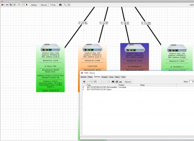

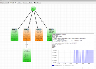

Понконтрол заточен в основном под BDCOM,в dude можно мониторить шо душа пожелает
Открываете ПХП и точите под нужные ОИДы. Проблем нет.

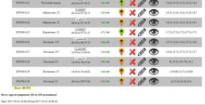

Я тут нервуюся, що в мене довго опитує:
<?php header('Content-type: text/html; charset=utf-8')?>

									//$opt_level_up = snmp2_get($ip_olt, $ro, "1.3.6.1.4.1.3320.9.183.1.1.5.$key");
										//echo $opt_level_up;
									if ($opt_level_up) {
										$opt_level_up = trim(str_replace("INTEGER: ", "", $opt_level_up)/10);
										$mac_onu = snmp2_get($ip_olt, $ro, "enterprises.3320.101.10.4.1.1.$key");
										$mac_onu = str_replace(" ", ":", strtolower(trim(str_replace("Hex-STRING: ", "", $mac_onu))));
										$active = snmp2_get($ip_olt, $ro, "1.3.6.1.4.1.3320.101.10.1.1.26.$key");
										$active = str_replace(" ", ":", strtolower(trim(str_replace("INTEGER: ", "", $active))));
										//$descr = snmp2_get($ip_olt, $ro, "mib-2.31.1.1.1.18.$key");
										//$descr = str_replace(" ", ":", strtolower(trim(str_replace("STRING: ", "_", $descr))));
										$Array_ports="";
										$Array_ports_="";
										$Array_ports__="";
										$Array_ports = snmprealwalk($ip_olt, $ro, "SNMPv2-SMI::enterprises.3320.101.12.1.1.8.$key");
											foreach($Array_ports as $key_ => $state) {
												$port = str_replace("SNMPv2-SMI::enterprises.3320.101.12.1.1.8.$key.", "", $key_);
												$Array_state=explode(":", $state);
												$state = trim($Array_state[1]);
												/*if($state == 1 ){ $state="up"; }
												if($state == 2 ){ $state="down"; }
												$Array_ports__[]= $port." : ".$state;*/
										//$Array_olt[$olt][$mac_onu]['ports'] = $Array_ports__[0];
										$Array_olt[$olt][$mac_onu]['key_onu'] = $key;
										$Array_olt[$olt][$mac_onu]['type'] = $type;
										$Array_olt[$olt][$mac_onu]['level_up'] = $opt_level_up;
										$Array_olt[$olt][$mac_onu]['active'] = $active;
										//$Array_olt[$olt][$mac_onu]['descr'] = $descr;
										else {
											$Array_olt[$olt][$mac_onu]['level_up'] = 0;
											$Array_olt[$olt][$mac_onu]['active'] = 0;
			ksort($Array_olt);
			echo "<form action=”onu.php” id=”form1”></form>";
			print("<br><br><center><table border='0' cellpadding='0' cellspacing='1' width='90%'>");
			print("<tr class=head bgcolor=#ffffc0>
			 <td ><strong>Имя ONU</strong></td>
			 <td ><strong>Описание</strong></td>
			 <td ><strong>Mac ONU</strong></td>
			 <td ><strong>Уровень пр., db</strong></td>
			 <td ><strong>GPS</strong></td>
			 <td ><strong>UB</strong></td>
			 <td ><strong>Edit</strong></td>
			 <td ><strong>VIEW</strong></td>
			 <td ><strong>История</strong></td>
			 </tr>");
			foreach($Array_olt as $key => $type)
				$olt = $key;
				$ports="";
				//$n="";
				//$m="";
				//$m_calc="";
				//$old_olt="";
					foreach($type as $key1 => $type1)
						$mac_onu = $key1;
						$level_up = $type1['level_up'];
						$type = $type1['type'];
						$active = $type1['active'];
						//$ports = $type1['ports'];
						//$d = $type1['descr'];
						$key_onu = $type1['key_onu'];
						$n++;
						$result = mysql_query("SELECT username FROM alldata WHERE maconu='$mac_onu'");
						$myrow = mysql_fetch_assoc($result);
						$username = $myrow['username'];
						$query="SELECT descr FROM pon WHERE mac_onu='$mac_onu'";
						$res=mysql_query($query);
						$itog=mysql_fetch_assoc($res);
							$d = $itog['descr'];
								if(($olt!=$old_olt)&&($n!=1)) {
								print("<tr class=head bgcolor=#ffffc0><td><font color=$warn>Всего: <b>$m </b>ONU</td>");
								$m=0;
								//echo $msg;
								//$m_calc=0;
								print("<tr height=40><td colspan=5></td></tr>");
								$m++;
								$m_calc++;
									if ($level_up == 0) {
												$colorfont="red";
												$level_up="0 ";
												//$lable="ONU не подключена!";
									}  elseif ($level_up <= -25.5) {
									  //  $lable="Плохой сигнал!!!";
									    $colorfont="blue";
									elseif ($level_up >= -10) {
									  //  $lable="Спасай глаз!!!";
									    $colorfont="black";
									else  {
									    $colorfont="green";
									  //  $lable="Сигнал в пределах нормы!";
						$cssClass="normalRow";
								if($n % 2 == 0) {
									$cssClass = "zebraRow";
						echo "
						<tr class=$cssClass>
						<td>$type</td>
						<td>$d</td>";
						if (empty($username)) {
							echo "<td>$mac_onu</td>";
						else {
							echo "<td><form action=reg-edit.php method=\"POST\" target='content'>
												<input  type=\"submit\" name=\"user_edit\" value=\"$username\">
												<br><lable>$mac_onu</lable>
										</form>
								</td>";
						echo "<td><font color=$colorfont><b> ".$level_up." db</b> <br/></td>
						<td nowrap align='left'>
								$query="SELECT lat,levelhystory FROM pon WHERE mac_onu='$mac_onu'";
								//$count=mysql_num_rows($res);
								//echo $count;
									$lat = $itog['lat'];
									$levelhystory=$itog['levelhystory'];
										//echo $lat;# code...
										if ($lat == 0) {
											echo "<a href='location.php?&olt=$ip_olt&mac=$mac_onu&lat=$lat&descr=$d' target='_blank'><img src='pic/red.png' height=\"50\"";
										} else {
											echo "<img src='pic/green.png' height=\"50\"";
							//if(($active==1)||($active==3)){ print("$ports"); }else{}
								switch ($olt) {
									case 'EPON0/1':
										$sfp_port_id=8;# code...
										break;
									case 'EPON0/2':
										$sfp_port_id=9;#
										break;
									case 'EPON0/3':
										$sfp_port_id=10;#
										break;
									case 'EPON0/4':
										$sfp_port_id=11;#
										break;
									default:
										# code...
										break;
								echo
								"</td>
								<td><a href='unbind_onu.php?mac_onu=$mac_onu&key_onu=$sfp_port_id&ip=$ip_olt' target='_blank'><img src='pic/delete.png' width=\"40\"></a>
								</td>
								<td><a href='edit_onu.php?epon=$olt&epon_onu=$type&mac_onu=$mac_onu&key_onu=$key_onu&descr=$d&ip=$ip_olt&port=$port' target='_blank'><img src='pic/comment-edit-icon.png' width=\"50\">
								</td>
								<td><a href='onu.php?epon=$type&mac_onu=$mac_onu& key_onu=$key_onu&descr=$d&ip=$ip_olt&port=$port' target='_blank'><img src='pic/view.png' width=\"60\"></a>
								</td>
								<td>
								 $levelhystory
								</td>
								</tr>";
								$old_olt=$olt;
						#######################################################3
						if ($m>"50"){
							$warn="red";
							$msg="<h3>Обратите внимание на порт. Заканчиваются места!!!</h3>";
						} else {
							$warn="black";
$c="";
$c=$m_calc+$c;
print ($msg);
print("<tr class=head bgcolor=#ffffc0 ><td>Всего: <b> $m </b>ONU</td>");
print("</table></center>");
echo "<label class=\"allonu\"><h4>Всего зарегистрировано ".$c. " из 256 возможных!</h4></label>";
mysql_close();
$time2= date("Y-m-d H:i:s");
   echo 'Start: '.$time1.' End:'.$time2.'</br>';
</body>
</html>
