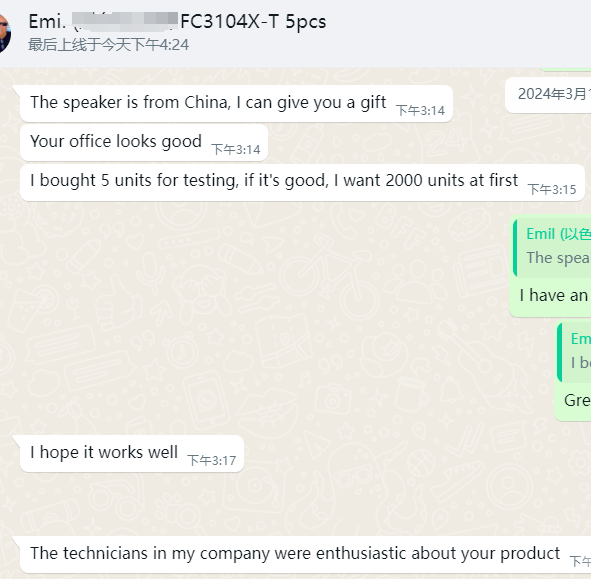

we have WIFI 6 ONU with CATV port, feedback from client are positive, he took 5pcs FC3104X-T for test order, he also offers TV service from local
On 5/17/2024 at 5:45 PM, Emelie said:
Ща прийдет китайская фарбика, будет рекламировать свои онухи.
your guess is right,  I'm right here?
