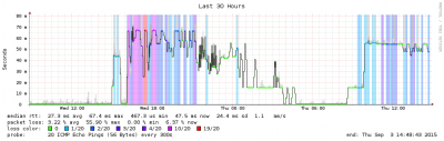

Google лихорадит?
+1
sudo ping -i 0.1  youtube.com
PING youtube.com (216.58.209.206) 56(84) bytes of data.
64 bytes from bud02s22-in-f206.1e100.net (216.58.209.206): icmp_seq=1 ttl=54 time=66.2 ms
64 bytes from bud02s22-in-f206.1e100.net (216.58.209.206): icmp_seq=5 ttl=54 time=66.2 ms
64 bytes from bud02s22-in-f206.1e100.net (216.58.209.206): icmp_seq=8 ttl=54 time=66.2 ms
64 bytes from bud02s22-in-f206.1e100.net (216.58.209.206): icmp_seq=9 ttl=54 time=66.2 ms
64 bytes from bud02s22-in-f206.1e100.net (216.58.209.206): icmp_seq=10 ttl=54 time=66.2 ms
64 bytes from bud02s22-in-f206.1e100.net (216.58.209.206): icmp_seq=11 ttl=54 time=66.3 ms
64 bytes from bud02s22-in-f206.1e100.net (216.58.209.206): icmp_seq=12 ttl=54 time=66.2 ms
64 bytes from bud02s22-in-f206.1e100.net (216.58.209.206): icmp_seq=13 ttl=54 time=66.2 ms
64 bytes from bud02s22-in-f206.1e100.net (216.58.209.206): icmp_seq=14 ttl=54 time=66.3 ms
64 bytes from bud02s22-in-f206.1e100.net (216.58.209.206): icmp_seq=15 ttl=54 time=66.3 ms
64 bytes from bud02s22-in-f206.1e100.net (216.58.209.206): icmp_seq=16 ttl=54 time=66.2 ms
64 bytes from bud02s22-in-f206.1e100.net (216.58.209.206): icmp_seq=17 ttl=54 time=66.2 ms
64 bytes from bud02s22-in-f206.1e100.net (216.58.209.206): icmp_seq=18 ttl=54 time=66.3 ms
64 bytes from bud02s22-in-f206.1e100.net (216.58.209.206): icmp_seq=19 ttl=54 time=66.3 ms
^C
--- youtube.com ping statistics ---
22 packets transmitted, 14 received, 36% packet loss, time 2162ms
sudo ping -i 0.1  google.com
PING google.com (216.58.209.206) 56(84) bytes of data.
64 bytes from bud02s22-in-f206.1e100.net (216.58.209.206): icmp_seq=3 ttl=54 time=66.2 ms
64 bytes from bud02s22-in-f206.1e100.net (216.58.209.206): icmp_seq=6 ttl=54 time=66.2 ms
64 bytes from bud02s22-in-f206.1e100.net (216.58.209.206): icmp_seq=7 ttl=54 time=66.3 ms
64 bytes from bud02s22-in-f206.1e100.net (216.58.209.206): icmp_seq=11 ttl=54 time=66.2 ms
64 bytes from bud02s22-in-f206.1e100.net (216.58.209.206): icmp_seq=18 ttl=54 time=66.2 ms
64 bytes from bud02s22-in-f206.1e100.net (216.58.209.206): icmp_seq=19 ttl=54 time=66.2 ms
64 bytes from bud02s22-in-f206.1e100.net (216.58.209.206): icmp_seq=20 ttl=54 time=66.3 ms
64 bytes from bud02s22-in-f206.1e100.net (216.58.209.206): icmp_seq=21 ttl=54 time=66.3 ms
64 bytes from bud02s22-in-f206.1e100.net (216.58.209.206): icmp_seq=24 ttl=54 time=66.2 ms
64 bytes from bud02s22-in-f206.1e100.net (216.58.209.206): icmp_seq=26 ttl=54 time=66.3 ms
64 bytes from bud02s22-in-f206.1e100.net (216.58.209.206): icmp_seq=27 ttl=54 time=66.3 ms
--- google.com ping statistics ---
27 packets transmitted, 18 received, 33% packet loss, time 2682ms
rtt min/avg/max/mdev = 66.244/66.287/66.313/0.087 m

пинг был то нормальный а от веб не открывался и почта тоже глючила
Абсолютно противоположные наблюдения.
опять нет интернета ...
DNS их что-ли используте?
Походу что-то с ихним  Укр. шлюзом. От немцев все ок:
105 packets transmitted, 105 received, 0% packet loss, time 104185ms
rtt min/avg/max/mdev = 5.493/5.698/7.418/0.276 ms
от нас
    Пакетов: отправлено = 97, получено = 64, потеряно = 33
    (34% потерь)
Приблизительное время приема-передачи в мс:
    Минимальное = 83мсек, Максимальное = 84 мсек, Среднее = 83 мсек
Edited by tkapluk
от нас
    (34% потерь)
Да у нас свои днс , но клиенты...
Гиганет сделал рассылку.
Добрый день.
Как многие наши участники могли заметить, в данный момент имеются проблемы с доступом к сервисам Google. Эта проблема НЕ в Giganet, и судя по всему общая для всех точек обмена трафиком в Украине, имеющим стык с Google.
Нам удалось связаться с их NOC, они в курсе проблемы и обещают исправить ее в ближайшее время.

Ну вы могли этого просто не заметить. У меня к примеру симптомы были примерно следующие:
-imap/smtp на gmail не работал (connection timeout). Из другой сети, по той же трассе - работал
-Вебморды гугла открывались медленнее обычного, но открывались. Обыватель этого бы и не заметил
-Видео на ютубе не открывалось несколько раз.
Так что возможно ваши юзеры были счастливчиками, у которых отвалился какой-нибудь мало кому нужный imap к гмейлу.

В общем вижу что гугл работать стал, но вот задержки к нему так и идут, очень похоже что кто-то из магистралов имеет проблемы.
Сервис деградирует в часы пик , такое чувство - либо упирается в кпд либо роутер проседает. На пингах есть потери , на тсп пакетах потерь нет.
Та же фигня, всё ещё наблюдаем потери на google.com:
При этом на на youtube.com или 8.8.8.8 - всё отлично.
